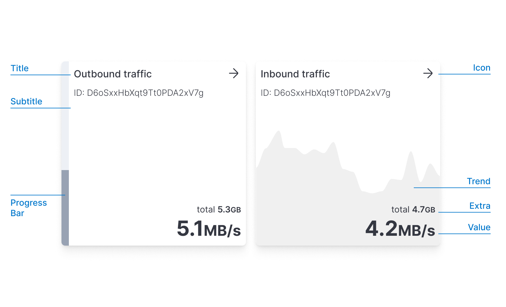

Anatomy
Anatomy of metric component
The Metric is used to convey a single numerical value. It usually can represent a specific indicator like: the current CPU value or the number of logs ingested in the last minute. Used correctly, can be very effective represent an overall status.

The value can be associated with a secondary visual representation that takes place in the background (like a progress bar or a trend), providing a contextual information layer.
Decorations
These secondary visual representations should be considered decorations. They cannot coexist at the same time (progress bar and trend) to limit the visual complexity and improve the understandability of the data
