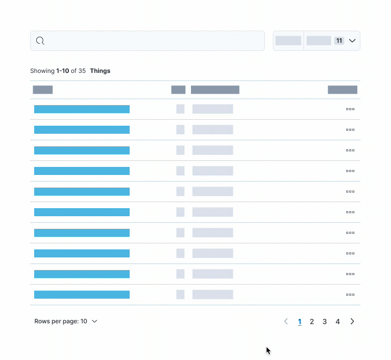

Lead with filters and search
For any results-style table, always provide ways to filter and search for content, first and foremost. Pagination is most effective after the user has reduced the number of results from thousands to hundreds of records, for example.
Display total results separately
When possible, always present a clear indicator of how many (and if not all results) have been returned. Just a simple count will do. Including a detailed summary of results at the top of the table or list goes a long way to signify what paging can’t.
Indicate indeterminate results
If you cannot provide a concrete number of results, you still have to communicate what the current results showcase. For instance, say "Showing first 100 results" or "Search results maxed at 1000" or "Results fetched at runtime".
Remember that not all users understand how your data API works. They just care about the data that's being shown to them.
Give users control
Providing a “Rows per page” option is often helpful enough to provide users control over the amount of data they see at once.
Keep the choices simple and only show “Rows per page” if there are more rows than the smallest option. For example, if there are only 9 rows and the smallest option is 10 rows per page, hide the selector.

Optimize defaults
Most users don’t customize the default view. Therefore, it’s vital that you provide optimal defaults and reduce complexity as the number of entries increase. This means choosing a default “Rows per page” that best corresponds to the total results. For instance, 1000+ results shouldn’t start with 10 rows per page, but rather 20 or 50.
Here are some samples of what controls to provide based on the number of data entries.
Total entries  | Rows per page options  | Pagination style  |
Total entries 0  | Rows per page options Use EuiEmptyPrompt in place of table  | Pagination style N/A  |
Total entries Less than 50  | Rows per page options Show 10, but allow All  | Pagination style  |
Total entries 51 - 100  | Rows per page options 10, 20, All  | Pagination style  |
Total entries 101 - 200  | Rows per page options 10, 20, 50  | Pagination style  |
Total entries More than 200  | Rows per page options 20, 50, 100  | Pagination style  |
Total entries Unknown  | Rows per page options Depends on what you expect the total entries to be  | Pagination style  |
If the total results are unknown, you can make a best guess based on the context of that specific table, whether there’s most likely going to be tens or thousands of results. From there you can decide to show 10 rows per page or 20 by default.
The complexity of the data will also contribute to this equation, which is why the table above is just a sample.
