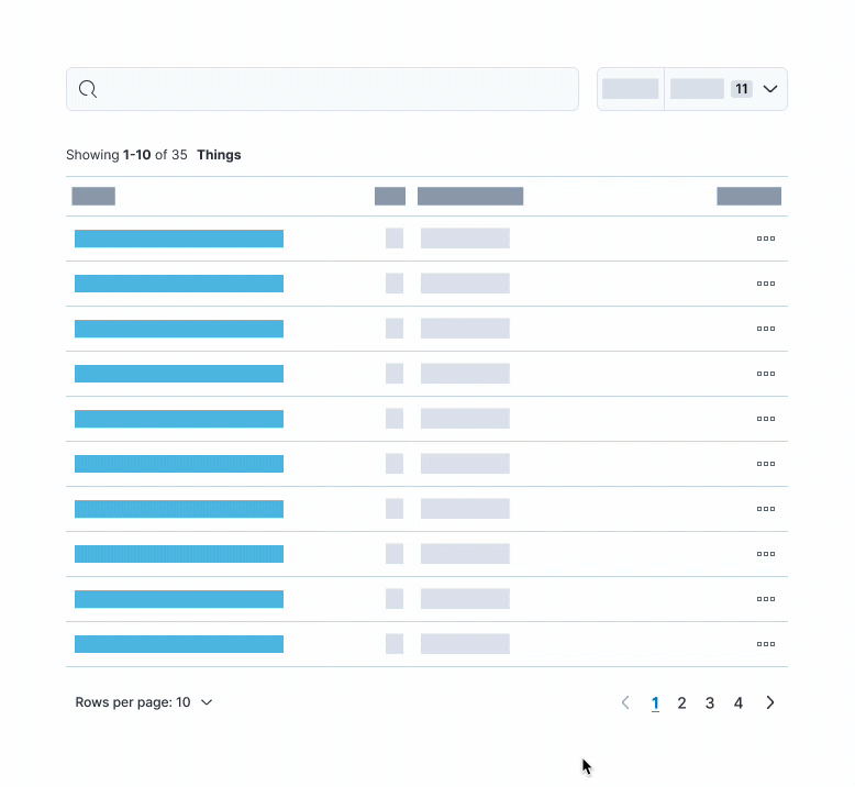

Lead with filters and search
For any results-style table, always provide ways to filter and search for content, first and foremost. Pagination is most effective after the user has reduced the number of results from thousands to hundreds of records, for example.
Display total results separately
When possible, always present a clear indicator of how many (and if not all results) have been returned. Just a simple count will do. Including a detailed summary of results at the top of the table or list goes a long way to signify what paging can’t.
Indicate indeterminate results
If you cannot provide a concrete number of results, you still have to communicate what the current results showcase. For instance, say "Showing first 100 results" or "Search results maxed at 1000" or "Results fetched at runtime".
Remember that not all users understand how your data API works. They just care about the data that's being shown to them.
Give users control
Providing a “Rows per page” option is often helpful enough to provide users control over the amount of data they see at once.
Keep the choices simple and only show “Rows per page” if there are more rows than the smallest option. For example, if there are only 9 rows and the smallest option is 10 rows per page, hide the selector.
