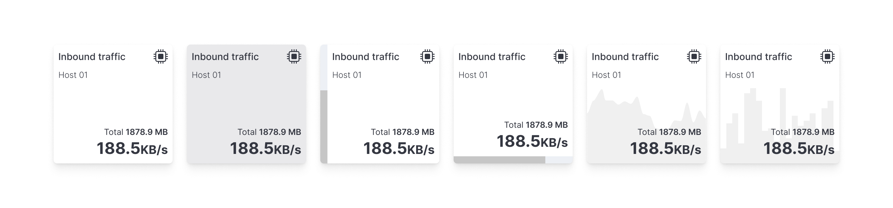

The Metric chart is a single value visualization available from Elastic Charts. It allows you to represent a metric, a KPI, a specific state with a very simple interface, similar to EuiStat but with more data visualization oriented capabilities.
Overview of metric component.

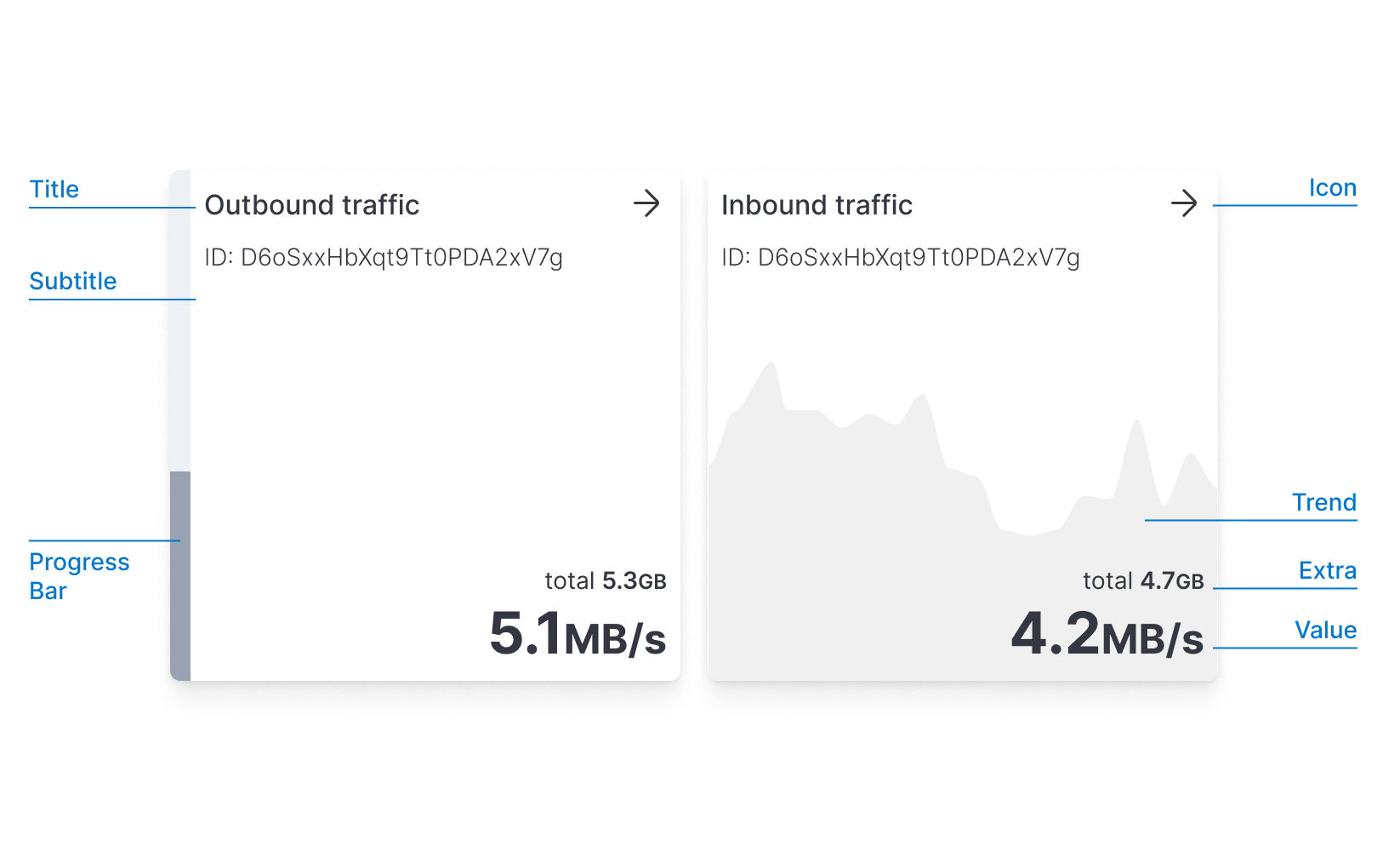

Anatomy
Anatomy of metric component
The Metric is used to convey a single numerical value. It usually can represent a specific indicator like: the current CPU value or the number of logs ingested in the last minute. Used correctly, can be very effective represent an overall status.

The value can be associated with a secondary visual representation that takes place in the background (like a progress bar or a trend), providing a contextual information layer.
Decorations
These secondary visual representations should be considered decorations. They cannot coexist at the same time (progress bar and trend) to limit the visual complexity and improve the understandability of the data

The metric can also represent a progress or a quantity within a range. This embellishment improves the context and increases the readability of the data.
The length of a bar is one natural representation of progress. To simplify the readability of the length, the bar always starts at zero.

Trend
A metric usually represents a statistic of a variable in a time frame. To add a bit more context is possible to represent the trend of that variable over time, by plotting an overlay on the metric background.
To achieve that, the trend needs to be filled with an array of objects in the form of {x: number, y: number}
The trend is then rendered following these principles:
  • the vertical height represents the range from 0 to the maximum y value.
  • the horizontal space represents the range from the minimum to the maximum x value
  • the trend height is limited to 50% of the overall Metric height, so the maximum y value always touches the vertical middle of the metric chart.
